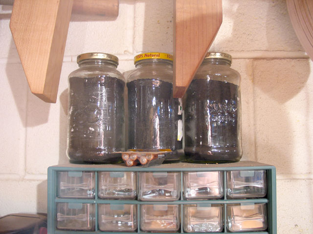

If you keep the dust in big jars like this, you can chuck a phillips screwdriver upside-down in your drill press and grind it (pharmacy style) into extremely fine dust in no time.
John Watkins38578.3198611111
John Watkins
